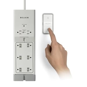

Belkin BG108000-04 Conserve Energy-Saving Surge Strip

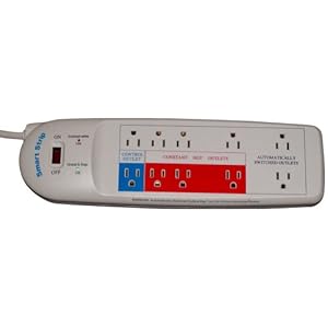

Or this... Smart Strip LCG3 Energy Saving Surge Protector with Autoswitching Technology, 10-Outlet

The first option seems to be a potential candidate, but another remote is not ideal.
I like the 2nd option for other places in my house, but not for what I want in my theater room.
If the first option could take wireless signals, then it would be ideal for what I have planned; however, I have a feeling it is IR or RF, which is not ideal for what I want to do.

I have different types of these devices in my house. Some have a sense outlet with the rest switched. Others have a sense outlet, some switched, and others always on. It appears that the smartstrip suggested by ctbaker is an example of the latter. Or you can have a normal power strip for those devices requiring continuous power and a switched strip for those that need to go on and off with another device.

I use the first two strips ctbaker listed - the conserve is in my office, so that if I'm not in there working, I can shut off all the LCD's (it's a quad monitor setup), plus the audio system and my IPPhone that hooks into the office; it keeps things quieter and saves power. For the 2nd one, it has an adjustable range that lets you choose the input sensitivity - seems to work ok for turning things on/off with the TV like stereo amps, etc. There are smaller versions that may fit better (like 2 outlets) with the projector/air purifier.
