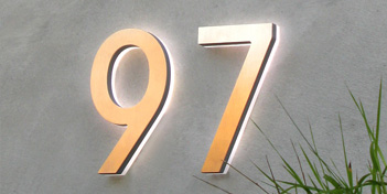

I recently purchased these LED house numbers and wanted to know if anyone has had any experience with wiring and programing these. I want these lights to come on at sunset everynight and turn off at sunrise. I dont think that i can pull power from the OmniPro II so was thinking i would need some sort of transformer to power them.
http://www.surrounding.com/Products/Luxello/Modern_LED_House_Number_5_Outdoor.asp
If anyone can point me into the right direction it would be much appreciated.
Thanks in advance!
Very nice LED powered house numbers.  Do you have to have a pair of wires per LED lamp / number?

Says 12 - 16V AC/DC. One pair per number.
Simple way would be to plug the transformer for these into a UPB outlet, or any protocol you use, and turn that outlet on/off as needed.
I'm in the process of improving the LV landscaping lights on the house I bought. In my last house, I had UPB switches control the transformers, and the Omni control the switches. But i was at Home depot lately, and the newest Malibu transformers have a clock and light sensor, they can go on when its dark and off when its light, or off at a certain time.The entire transformer was $40 bucks. A UPB switch alone is $55+. You could use the same thing. Buy a 45 watt low voltage landscape transformer, set it to go from dark to light, and your done. The simplest solution is the best.

Looks very attractive, and I like the idea.  The devil is in the details though: I wonder how well that acrylic backer will hold up to outdoor UV exposure?  It might go from white to yellow to brownish....
