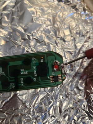

Well, never mind I guess. I was able to find that solder had broken free from the pcb going to the IR bulb. Quick solder job and the remote now works.
