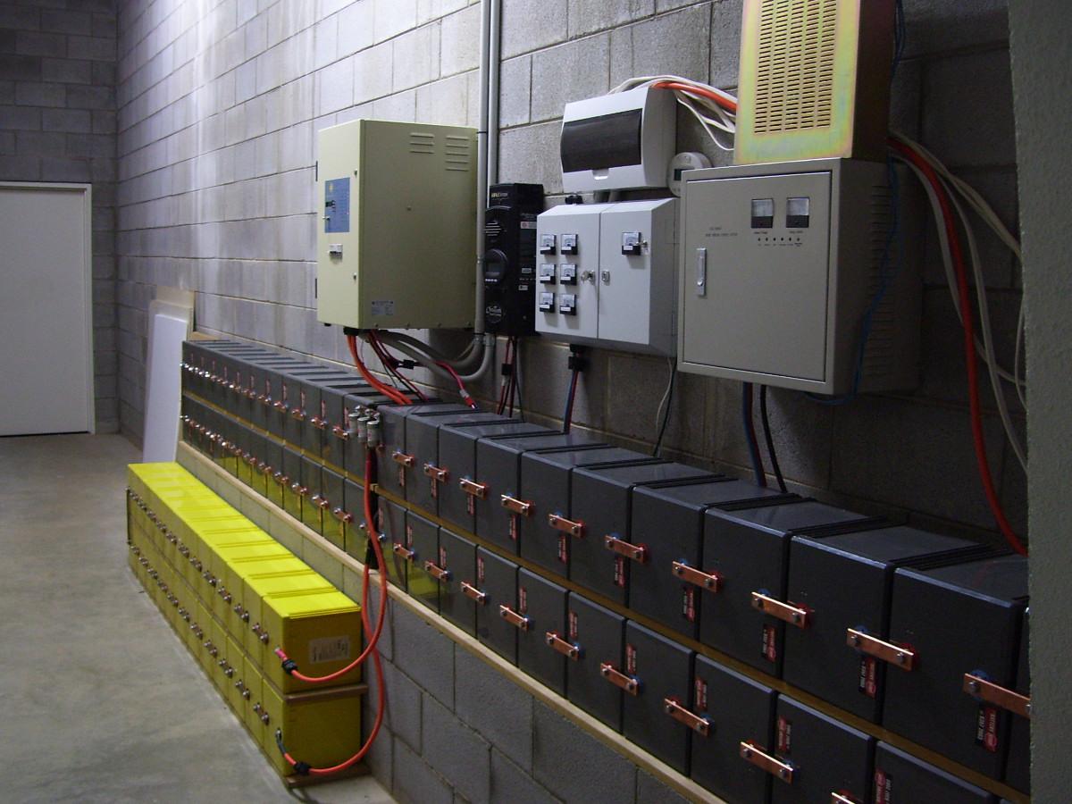

No supercap made to date will store the 10+ kWh I need overnight!
I use VRLA AGM cells, 2V/500AH per cell, 24 cells per bank, 3 banks.
At 50 amp constant draw, under perfect conditions you get 30 hours?  With an overcast day and only a little wind, how long does it take to recharge the entire system? At only $0.04 per kw, I'm still a ways from going off grid.

Peukert has some things to say about discharge rate and capacity. But in theory, yes, I could drag 50A for 30 hours, and it would then take about 15% longer to recharge them at the same rate.
In reality, discharging lead-acid batteries more than about 20% of their capacity severely reduces their life, so I wouldn't ever discharge them that deeply.
