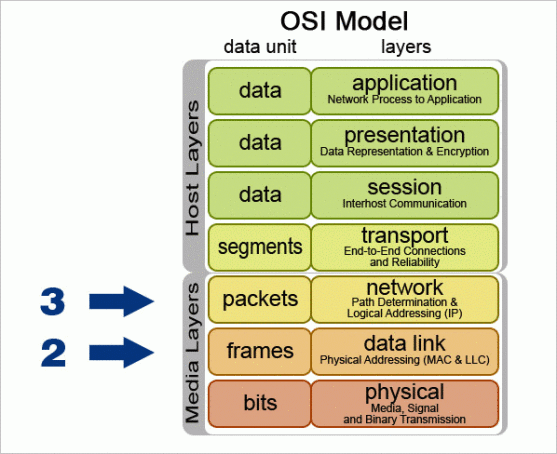

Here is some basic networking stuff for quick reading.
Layer 2 is the data link where data packets are encoded and decoded into bits. The MAC (Media Access Control) sub layer controls how a computer on the network gains access to the data and permission to transmit it and the LLC (Logical Link control) layer controls frame synchronization, flow control and error checking.
Layer 3 provides switching and routing technologies, creating logical paths, known as virtual circuits, for transmitting data from node to node. Routing and forwarding are functions of this layer, as well as addressing, internetworking, error handling, congestion control and packet sequencing.
To summarize:
Layer 2 Data Link: Responsible for physical addressing, error correction, and preparing the information for the media
Layer 3 Network: Responsible for logical addressing and routing IP, ICMP, ARP, RIP, IGRP, and routers
Some advantages of Layer 2 include lower costs, only requires switching, no routing gear is necessary and offers very low latency. Layer 2 also has some significant disadvantages such as the lack of router hardware, leaving them susceptible to broadcast storm and the additional administrative overhead of IP allocations due to flat subnet across multiple sites.
Layer 2 networks also forward all traffic, especially ARP and DHCP broadcasts. Anything transmitted by one device is forwarded to all devices. When the network gets too large, the broadcast traffic begins to create congestion and decreases network efficiency.
Layer 3 devices, on the other hand, restrict broadcast traffic such as ARP and DHCP broadcasts to the local network. This reduces overall traffic levels by allowing administrators to divide networks into smaller parts and restrict broadcasts to only that sub-network.
