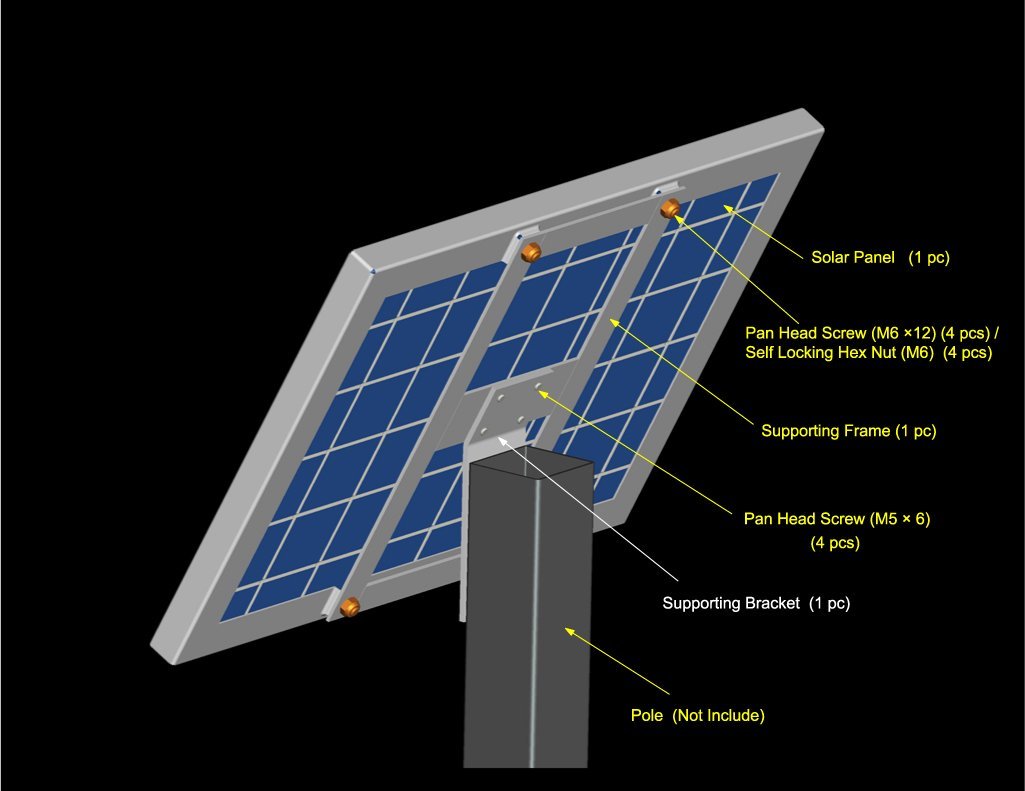

I have a 13" x 21" solar panel on order for a solar garden light project that I'd like to install at close to ground level.  One of the panel's selling points for me was that included in the price it comes with a bracket for mounting the solar panel to a post, as shown in the rendering below:
Tentatively, I would buy some square tubing and secure it to the ground by putting it in a hole that I would then fill with a bag or two of quikrete.  That way, the pole and panel hopefully won't tip over in heavy wind, and it will also hopefully deter any thieves from pulling the whole assembly out of the ground and making off with it.  So, after cementing the post into the ground, the next vulnerably becomes the fasteners that attach the bracket to the post and to the panel.  I'm wondering what kind of fasteners a thief would be highly unlikely to have drivers for, so that he wouldn't just unscrew the fasteners and make-off with it?  Any experience or opinions on that?

A fastener with a spin collar will defeat the dremel, especially if the collar is conical (no vise grips there). Using tamperproof is only as good as you make it, and again, it's not a 100% guarantee it won't get stolen, but the longer it takes, the more noise, the more exposed, the less likely.
