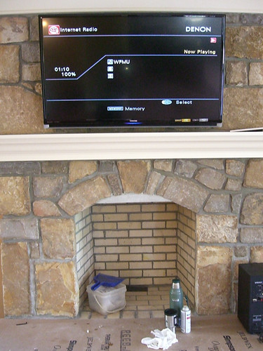

Next up is the Toshiba 52" XF550 LCD TV above the family room fireplace.
