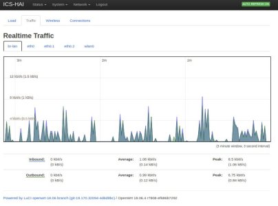

Here is a snapshot of the traffic that goes to the Ethernet Port on the OP2 via the router.
Will connect the OP2 ethernet port to a managed L2/L3 switch port and post a graph of all of the traffic on my LAN going to the Ethernet port non routed.
