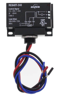

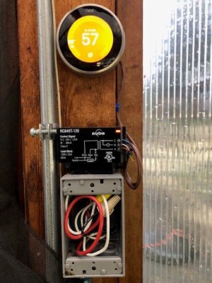

Found this nifty relay for controlling 240 vac or 120 vac heaters from a low voltage smart thermostat. The devices have built in transformers providing 24 VAC for the thermostat. Available at Supplyhouse.com. I have no connection with the company. As an example, installation of a nest thermostat in our green house.
