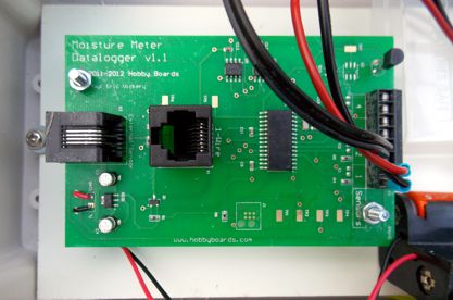

Here many years ago purchased the Hobby Board moisture sensor, Gypsum Soil Sensor and Leaf Wetness Sensor. (~2006??)
I never saw a moisture meta data logger or mention of a Hobby boards moisture meter data logger on the HB site. (unless I missed it)
Documentation to the Hobby Board moisture sensor was:
Moisture Meter
The Moisture Meter measures moisture levels as detected through either a Gypsum Soil Sensor or a Leaf Wetness Sensor. It works by measuring the resistance of these sensors, which decrease as moisture levels go up.
To set up the Moisture Meter, you will need to connect all 5 terminals of the screw terminal. Two of the screw terminals connect the Gypsum Soil Sensor or the Leaf Wetness Sensor; see below for installation instructions for these devices. To connect the Moisture Meter to your 1-Wire network, simply connect the 1-Wire data line to the screw terminal marked DQ, and connect the 1-Wire ground line to the screw terminal marked GND. This device also requires 9-24 volts of external power, which should be connected to the screw terminal marked +12v and GND. For more information, please see our general discussion of Connecting Devices to the 1-Wire Network.
Since your Moisture Meter will most likely be installed in a humid environment, you should take precautions to protect it. The board should be mounted inside a weather-tight enclosure if possible. We recommend coating the device with a spray coating, which is available through us when you purchase an assembled device. If you coat the board yourself, use liquid electrical tape or spray varnish. Apply the coating after the connections have been made, and be sure to coat the terminals well. The Moisture Meter does not have RJ45 connectors, as they may not hold up as well in outdoor exposed conditions.
The Moisture Meter is a relatively new 1-Wire device. It will work with any software that supports a DS2760. If you have favorite software, you should check whether the device is supported. An increasing number of software vendors are including support for this device.

The sensors and 1-wire board did not work for my needs and I abandoned my efforts - (thinking it is still in my one wire box o 1-wire trinkets).
I am not sure that HB sold a 1-wire data logger.  Thinking they sold a 1-wire sniffer at one time.
