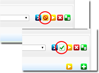

Edokid - Did you enable the event after you created it?  New events are disabled by default to prevent them from triggering while you're creating them.  check this and enable the event.
