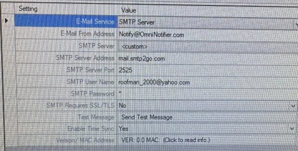

My email notifications stopped a few months ago, July I believe , is HAI Omni Notifier still sending notifications from my Omni system ? IF not do I have any options?

Who are you connecting to for processing your mail? Some have switched to only encrypted access which the Notifier doesn't support.
Guessing when it sends
connects to mail.smtp2go.com 2525
From [email protected];
To [email protected]
You have an smtp2go account?
If not, why are you using smtp2go as the relay?
The [email protected] email needs to be verified with smtp2go.com
When you verify, it sends an email to that address ([email protected]) and to confirm you need to reply or click the link (don't remember which its been so long)
omninotifier.com domain seems to be owned by ionos.de, a german web company
I had a similar problem when using fake email -from- addresses, which worked find until I started using smtp2go, and had to change them over to real email addresses and verify them with smtp2go.
