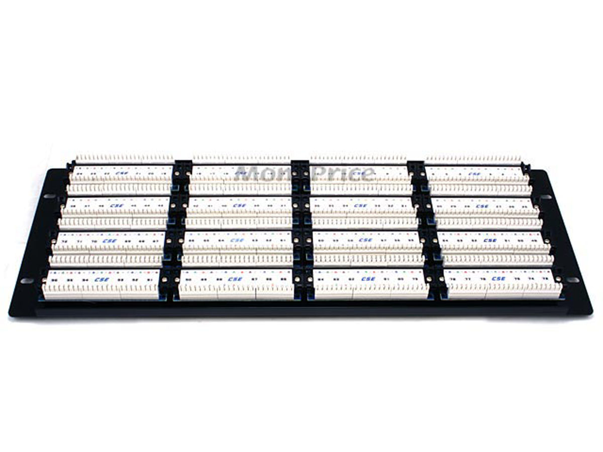

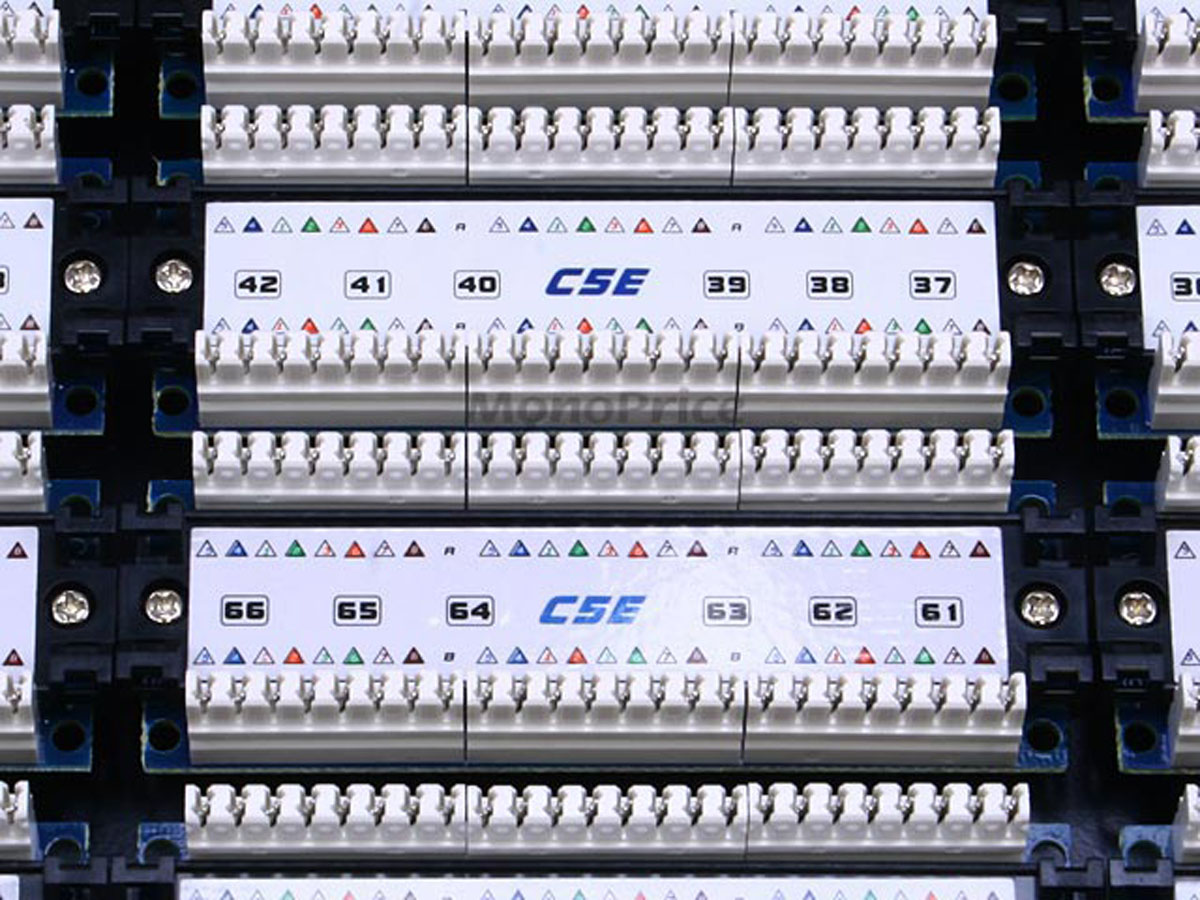

About 7 years ago I started the less-common but incredibly versatile trend of running Cat5e only to every office... A cube gets 3, an office gets 3 each on two opposing walls. I was just tired of having to grab tools to move phone lines, extensions, etc - and I was lucky enough that all of our offices have expanded over the last 5 years so I've gotten to re-wire every one in this fashion. Generally I fly to the site to manage the install and hook up the basics, then head home (I should send one of my guys, but I don't have anyone with the networking and telecom knowledge I have). The great thing is, because things are labeled and I keep pictures, even if I leave and they decide to reconfigure where their digital phones are, fax lines, and PC's, I can generally walk an unschooled admin through any change. And, I've never had to add wires to a single office again. Using the Cat5, I can pump video, powered ethernet, analog lines, digital lines, powered polycom phones, and anything else you can imagine through the Cat5. When sending a phone through, just use an RJ11 and it'll do just fine. You can also use RJ45 patch cables for phones if you're patching around a wiring closet - it doesn't make a difference - they're just more expensive.
In the past before I had laid the wires, or in extreme circumstances, I've done some trickery where a digital desk phone, an analog phone line, and a 100BT ethernet connection have all run through a RJ45 jack using splitters at the patch panel and jack. They also sell some standard splitters that'll let you run two 100BT connections over a single Cat5. Even today I showed someone how to send 4 phone lines over a single Cat5 through a single jack, then made a patch cable that was an RJ45 on one and and 4 RJ11's on the other end (dense modem-boards where I don't want 8 phone lines into a 1U server) just to make things cleaner.
