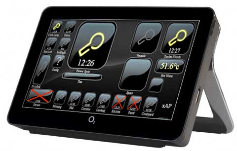

I still utilize the above posted table top tablet (one of the first cloud based OS's introduced as an Apple killer by John Skully working for OpenPeak).  Modded said tablet replacing the EFI boot bios with Seabios, installed an SSD drive, RTC clock in it.  Stock device had built in Gb, Bluetooth, WLAN.  Today you can run Linux, Android or Windows on these just fine.  Today these are running Ubuntu 20.04 Linux, Squeezeplayers, HA interfaces and Homeseer Touch on Windows embedded.  Windows tablets run MS SAPI TTS / VR (this was way before Alexa / Google devices).

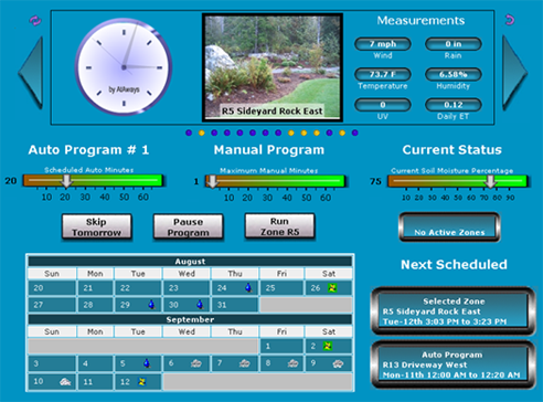

Tinkered a bit here with Plug computers a while back.  First automated irrigation system ran on a Seagate Dockstar with Debian / Mono installed on it running mcsSprinklers.  Fit this all in a Rainbird irrigation box and installed a touchscreen for interface to irrigation many many years ago and used xAP.
