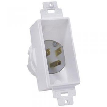

I added a 120V outlet on the wall above the panel, I plan on putting a rackmount open-frame wall mount cabinet up there for gear and my UPS to get it off the ground. Is there any code-legal male AC power connectors that I can put on the wall to feed from my UPS and wire it to a 2nd outlet box inside my panel? Can I mount a Hubbell HBL5278C on my wall?

I used this Midlite male outlet to run my enclosure power to a UPS in my rack.
http://www.amazon.com/MIDLITE-4642-W-Single-D%C3%A9cor-Recessed/dp/B002XDQAA6/ref=pd_bxgy_e_text_y
That is perfect. Ordered one today! Thanks.
