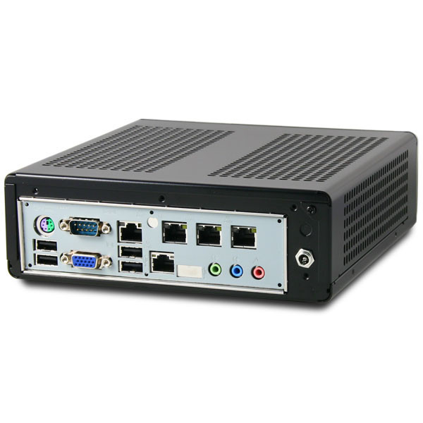

That Smoothwall box ran on a few different CPUs over the years and started with an Intel 400Mhz device (old SQL server).  For a time was into the smaller footprint thing and went to an overclocked AMD in a Netier embedded terminal PC with three network interfaces running from a CF Drive.  Worked fine.
Most of the combo off the shelf SOHO devices; IE: switch and router or switch, AP and router utilize tiny CPUs, little memory that you purchase today are really OK for a few devices on the home network; but really they are cheap and basically functional junk.
My last DIY PFSense firewall I went to a core duo mITX commercial board with two built in Gb NICs and added 4 Intel Gb NICs.
It is using an IGo Logic Motherboard.  (purchased in bulk as the BCM mITX boards).

I used a sort of media case for my PFSense firewall.  It is a small footprint case which allowed me to stack two dual Intel NIC cards.
That said I use these cases for my carpc's which are really tiny.  Using one of these for my Homeseer 3 Wintel server (mostly off these days).
