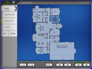

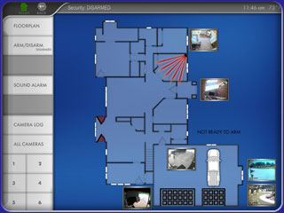

So we, Cinemar, came up with a Floorplan Design Service that's been hugely successful and created by professional designers:
http://www.cinemarsolutions.com/services.floorplans.php
We actually break up each room as individual objects so they can be utilized as clickable areas in MainLobby. Some like to show the room in yellow if any light is on in that room.
Our pricing is based on making a custom library of your floorplan for seamless integration into MainLobby. For users of other automation packages that don't need this high level of customization, we may be able to offer price breaks based on your provided plan and needs.
Floorplans are great since you can utilize them in many aspects of automation (security, lighting, thermostats, whole house audio/video, etc.)
Our standard library that comes with Mainlobby includes objects that fit nicely onto your floorplan too. You'll find Nuvo & Russound keypads, spinning ceiling fans, door swing left/right, garage doors, motion sensor animations and much more. This allows you to spend less time doing design work and more time on customizing your automation system.
