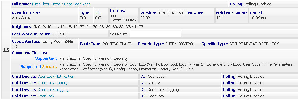

Anyone know whether better diagnostic tools are possible/available under zwave+ than was the case under regular z-wave?
We've implemented a couple of nice improvements that enhance reliability (using a Z-Wave Plus controller, like our Z-NET):
  • Last Working Route is a feature that reverts to the previous successful controller-stored route, if the currently chosen route fails.
  • You can set the command route from the controller to the node you wish to control.  This is particular useful if the route set automatically by the controller doesn't seem to make sense or if you wish to avoid certain nodes (like plug-in modules) that may possibly go off the network (kids or cleaners unplugging them).
    Example: My door lock could not communicate directly with my Z-NET and the default route established during inclusion was to use an HSM200 plug-in multisensor in between.  However, the multisensor was located out in my shed!  That's a pretty odd route. So, I changed the route to use another node inside my home. The "Set Route" field below is where the route is entered. The "Last Working Route" then changes to the nodes you choose.
