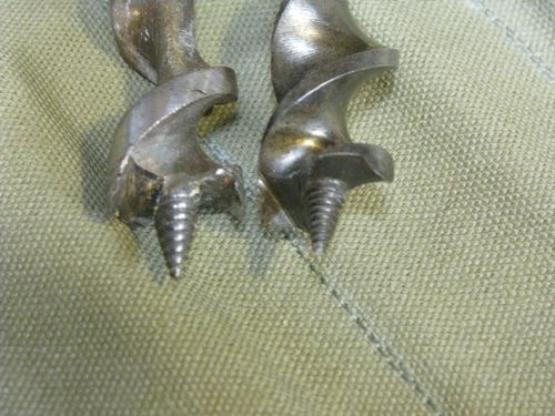

Forget the right angle drill except for really tough locations. They are hard to get enough pressure to make it fast. Not enough pressure will make your bits overheat and lose their temper and dull quickly.
With an auger with a lead screw, you don't need any significant pressure--the screw draws the auger bit through the wood. Not that in the old days, bits were available with fine, medium and coarse thread lead screws for hardwood, softwood, and green wood (not dried, very soft).
Nowadays, you would have to search high and low to find anything other than medium thread. I believe he bits pictured above would be considered medium (left) and fine.
Craig
Gratuitous old tools tip: If you use a brace and count the number of turns, you can repeatedly drill to the same depth since the lead screw will advance a certain fraction of an inch for each turn. For example, an 8 thread per inch screw will drill 1.5 inches in 12 turns.
