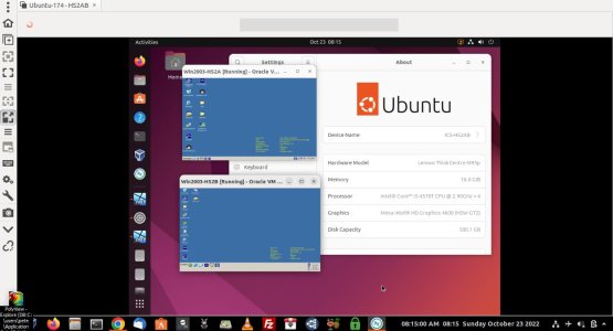

Personally here running two W2003 32bit HS2 Virtual boxes on Ubuntu 22.04. I am using them mostly for running two Way2Call boxes connected to two VOIP lines. Using a CID announce and blocking script integration to HSPhone from years ago. I used to run HS2 as a service too. Today not doing this. You can also run the Ocelot and connect that to a TW-523 or Jeff Volp's dual phased TW-523 emulator which I am doing today for my HAI OmniPro 2 panel. Keep the Elk

The Homeseer X10 plugin has been much improved for HS3/HS4 with diagnostic data views. Way back purchased a "few" Digi Edgeports (8 and 16) and they work just fine directing them to different serial ports on the VBs. Each VB is around 20Gb which does make them portable. There is another VB on line with multiple MS SAPI voice fonts running with multiple instances of Homeseer Speaker app. The VR/TTS is not cloud based and works fine.
With HS3-4 have moved these days to Ubuntu with Mono running. Some pieces run in Windows virtual boxes. These pieces manage my Wintel tabletop touchscreens with MS SAPI. I could only get Windows SAPI running in PlayonLinux but it is not as good as running SAPI on Windows.

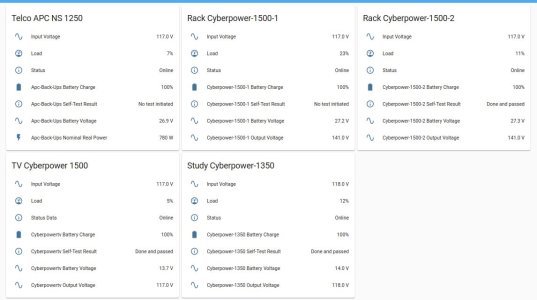

Newest automation box runs Homeseer 4 and current Home Assistant. Homeseer 4 talks MS SAPI and Home Assistant both talk MQTT these days.
