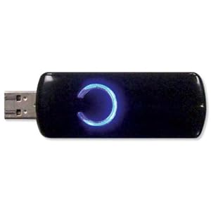

Got the new stick today.  It appears to be working OK.  I loaded Installer with the stick in the USB port and it loaded and appears to give me what I would expect to see.  All of the options are now available and not greyed out.  At this early stage, it appears the first two were indeed defective.
I'm wondering if Leviton put out some bad ones, or if Amazon keeps sending the same one back out.  We'll never know.
So, tomorrow it's build a new Z-Wave network.  With only 11 nodes, that wont' be the biggest challenge.  It's still white knuckle time getting it transferred to the VRC0P and then working in CQC.  No reason to think that won't happen, it's just always a tense time until you know the issues are behind you.

I think I may have figured out why the sticks kept coming up defective.  They have to be plugged into my laptop before the laptop is booted up.  I thought it would be sufficient to simply have them plugged in before loading the software, but not so.

@NeverDie: If I understand your problem correctly you just want to extend the range of the remote connections? Or do you want to have like a failover cluster - like for database servers (if one controller fails it should utilize the other one)? In case you just want to have a more reliable connection I could recommend Z Wave range extenders since Z Wave is fully mesh networking compatible. This is the Aeon Labs Aeotec Z-Wave Range Extender/Repeater which works quite well:

I have a VRUSB from Amazon. Never worked and beyond return period. If I buy one from AO, can I have confidence it'll work?
