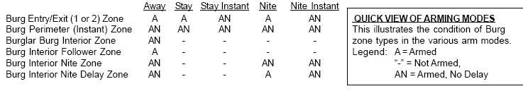

The chart on page 30 in the M1 manual is the best way to keep it straight. I will try to paste it here, but it won't format right.
Code:
Away Stay Stay Instant Nite Nite Instant
Burg Entry/Exit (1 or 2) Zone A A AN A AN
Burg Perimeter (Instant) Zone AN AN AN AN AN
Burglar Burg Interior Zone AN - - - -
Burg Interior Follower Zone A - - - -
Burg Interior Nite Zone AN - - AN AN
Burg Interior Nite Delay Zone AN - - A AN
