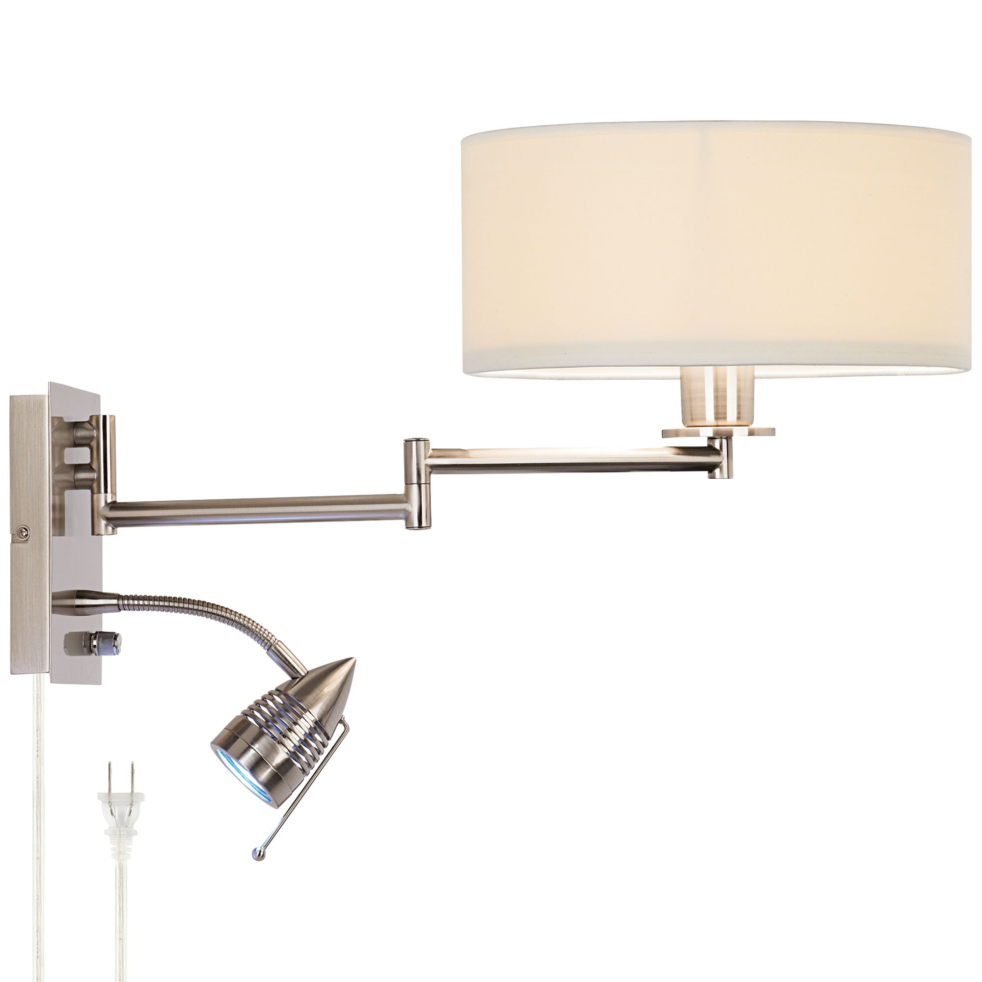

So I'm looking to find some kind of similar no/low-heat lighting for this purpose. One that clamps and has a gooseneck would be ideal, but at some point I'd be willing to punt and go with something that hung on the wall.
Anyone run across a lighting need like this?
