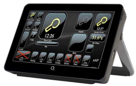

Personally here still using Openpeak Atom based 7" tabletops (can be used in wall and with POE). Running with 15 tabletops managed by Homeseer and each run Microsoft SAPI. They are getting slow and working fine after 10 years now. They run embedded Windows (using Seabios) and have all been hardware modded. These run OmniProTouch and Homeseer Touch and do OK running Home Assistant in Opera. They are about 1" thick. They also run as Squeezeplayers. (Linux, Windows and Android).
They have microphones (working with SAPI). Did test the Atom Home Assistant test device plugging it into side USB port. Works fine for VR.
Personally here do not want to hang a tablet with batteries. I do use Android and Windows tablets today and they work fine.
Year before last tested used Axis-TV-1000p's that I purchased for $50 used. These worked fine and were POE. Only thing was that there was a custom bios with a maximum of 800X600 display on the LCD touchscreens.

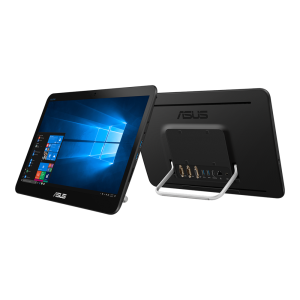

Year before last also tested an Asus AIO which also works fine. It is not POE. It is thin and runs Linux and Windows 11 fine.

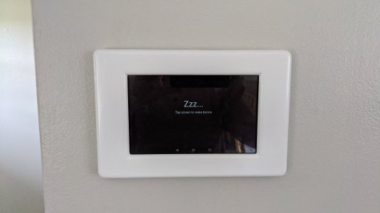

I use POE to USB adapters and just leave them plugged in. No need to worry about batteries dying that way.
3D printed a case for them and it mounts to a 3 gang box. The adapter is in there.

AIO approach is not a bad idea at all. Only question is the price of these units, which puts it in the same range as the touchscreen/KVM-over-CAT6 combo which would be more future proof. Will have to set up some deal alerts just in case something pops.

Purchased the Asus AIO as a refurb like new device for around $100 a couple of years ago. I updated it to 8 Gb and an SSD drive. It is commonly used in medical offices and as point of sale devices. It will work with POE ++ (802.3BT).
