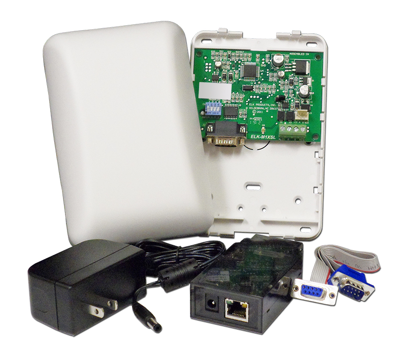

Does anyone know if there is a way to connect an Elk M1 system to RadioRA3? I have the M1XSLU module but it requires an RS232 cable connection to the old RadioRA2 main repeater. The RR3 main repeater has no such connector, only RJ45.
Thanks!
When I check, the following Lutron services are supported. RadioRA 3 moves to PoE, so that RJ45 is an ethernet jack. At this time I cannot find any integration solutions for direct Elk M1G -> RadioRA 3. The last I checked, only Samsung Smarthings had a RadioRA 3 integration. While round about, you could do Lutron RadioRA 3 -> Smarthings -> Home Assistant -> Elk M1G integration via Serial or M1EXP.
