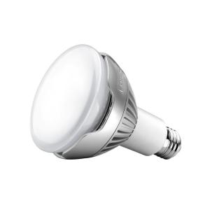

I just installed these in the recessed kitchen fixtures:
They're Philips AmbientLED 13W (65W equivalent) BR30 floods designed for recessed fixtures. Fully dimmable. The 3000K temp is perfect for the kitchen as its a bit whiter than an incandescent but still soft. The family loves them! $38 at Home Depot...
Please let us know how these work for you.
I installed 4 of these, and after about 6 months of heavy use, 3 of them started a random flicker. Put them in different fixtures same issue. Replaced them with 3 of the same, and so far no issues
