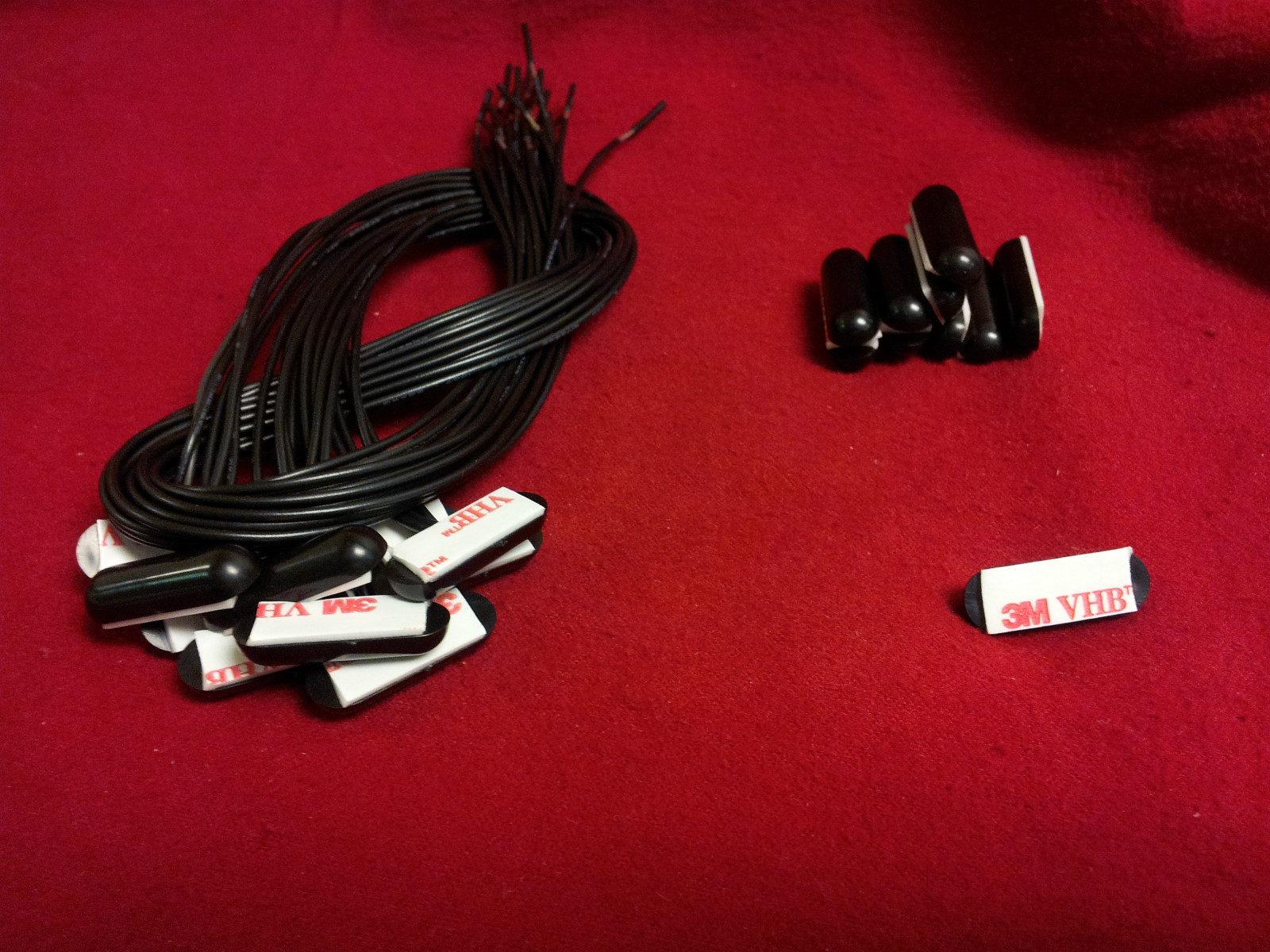

You can use this model, they are easy to instal

Michael - I generally have been sticking with GRI products for contacts and sensors, when I can. Quality products, good company.
Edit - Michael, I figured out those are surface mount contacts, pictured. I'll try to use flush mount.
