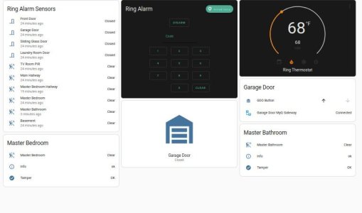

Here in Sandbox house #2 went to using the Ring Alarm stuff. The Ring hub speaks ZWave. I am managing it from house #1 via the cloud. Also using modded WiFi Tasmota devices (temperature, light switches et al) and Amazon devices in every room of the house.
Recently add a few Amcrest PTZ cameras and Tasmota wireless combo humidity / temperature sensors.
Can also manage TV, DirectTV box and Media player remotely from house #1.
The Ring hub is POE wired to the network with fail over to cellular at around $8 a month. Manage the system via HA versus my phone.
