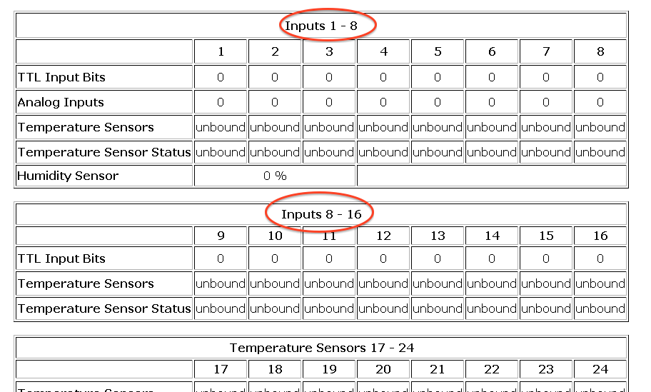

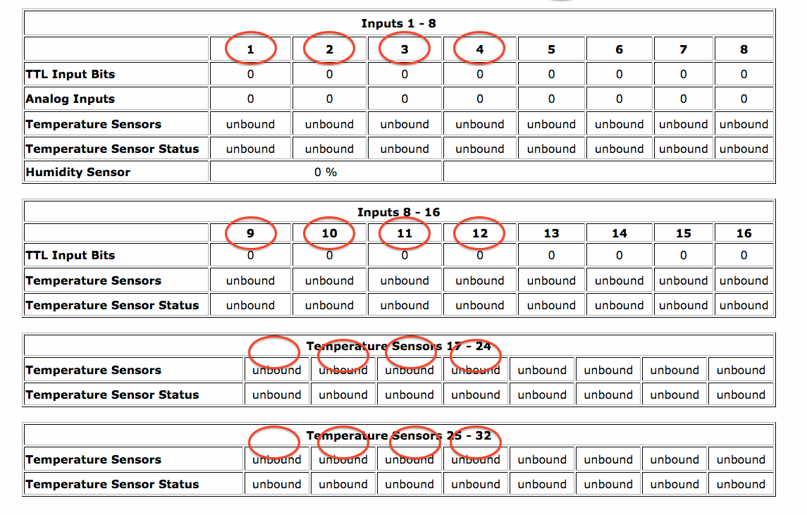

On the status page, Temperature sensors 17-24 and 25-32 still have no column headings.
When green LED flashing fast, the is the indication that the board still in firmware update mode.  It might be the "run application" click lost somehow over the network.
I saw the temp sensor heading in the main index.htm page. When you say status page, do you mean that page or status.xml?
Oh, and looking at it.... the second line shouldn't read inputs 8-16 either, it should be 9-16 :)

Ross, please try download again. This version supports also "%d", there is no zero padding for this format.  Please also update GUI and API for the temp sensor header numbers
Looking good Wayne. Major improvements, everything appears to be working as it should.

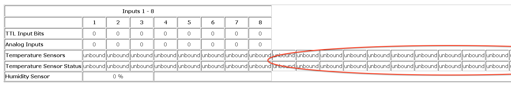

Just a couple of cosmetic things.
