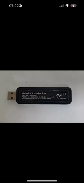

I would like to install Zwave door lock on my system and I need help. I bought on eBay 2 Zwave switches and the Leviton Vizia remote control and I never succeed the integration. I heard about the Vizia USB stick like VRUSB-1US can do the job???? Is there somebody that can help me for my project?

I know I am late to the party here but did you get your z-wave lock(s) paired and working? I have two Schlage and one Yale lock on my OmniProii system working. Willing to help? Did you find the article on reverse association? The Z-wave Vizia RF program reverse association does not work but codes can be sent directly using Putty through the VRCOP module to make the reverse association function.

I posted the above when I found you note. I was looking for any information on getting the Yale YRD 210-ZW working with the OmniProii. I have had Yale 220-ZW working on the system for years but it finally died. Amazon has the Yale YRD 210-ZW Z-Wave lock for about $38 with is a great price. These are factory reconditioned (not clear on offer), are the older version of what I had installed and working, and I went through 2 that would not pair. The 1st of the second two I received as replacements paired fine and can be controlled (Locked and Unlocked) using the Vizia RF program (codes sent through the Vizia RF installation tool - your pic above). But, I cannot get the OmniProii to control it. I, of course, have updated the VRCOP after pairing but just won't communicate with the Yale lock. It does still control my two Schlage Z-Wave locks. I assume there is some issue with the older Z-Wave module in this older lock that is causing an issue but really just a guess. If anyone has any ideas for what to try, please let me know.
