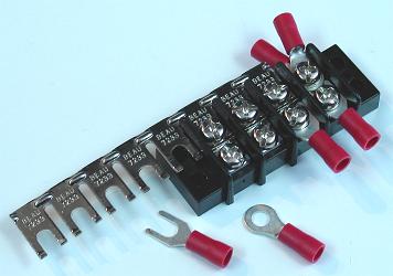

I just added a Secu-16 to my ocelot setup. I now have the Ocelot, Secu-16IR and the Secu-16. The devices are on my desk now but I am looking into picking up a ELK EZ8 and I would like to put all this in 1 can. I have the wires now from the power supply going to a wire nut that then feeds each unit but I would like to find some kind of wire block that I can mount in a can and power all the units.
I was thinking something like this http://nbkf.manufacturer.globalsources.com...inal-Blocks.htm but that is mountable.
I was also wondering what size can should I get.
You could consider a terminal/connecting/barrier block, with jumper strips or jumper wires - the blocks are sold at HD/Lowes, unbelievable variety online.
DIN Rail mount terminal blocks are another options, but expensive, and also an overwhelming variety online.
