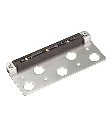

Basic layout idea. I like lips (prob square not round) so I can hide led strips under bottom one. I think two sets of concrete is best, so my downlighting doesn't effect the backlit numbers.
