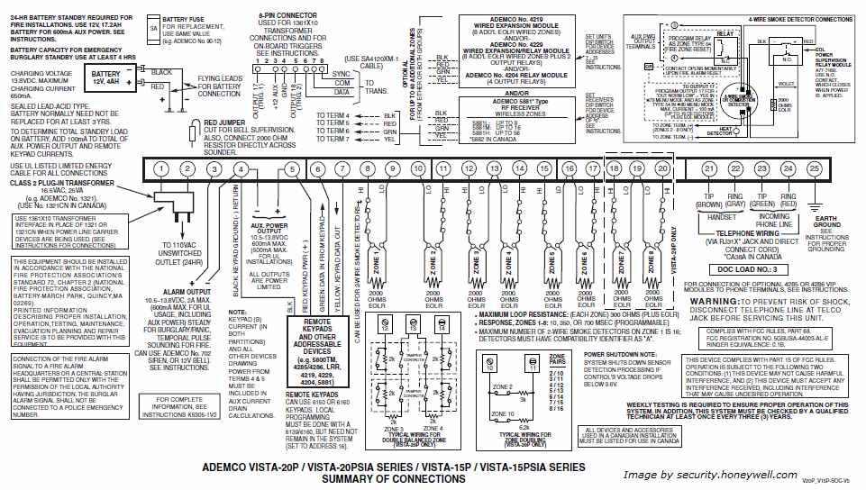

You want to find a diagram like this for your specific model (unless there is one in the door).
Proprietary Scantronic panel.
Pete's "bubbles" are incorrect and could be confusing to the OP.
The battery, RJ31X and major system components are valid, but the rest aren't ;)

Not faulting you Pete, just helping the OP get clarity.

Understood Del.  Yup; did a very quickie drawing and did label it not knowing where anything was on the panel board.
