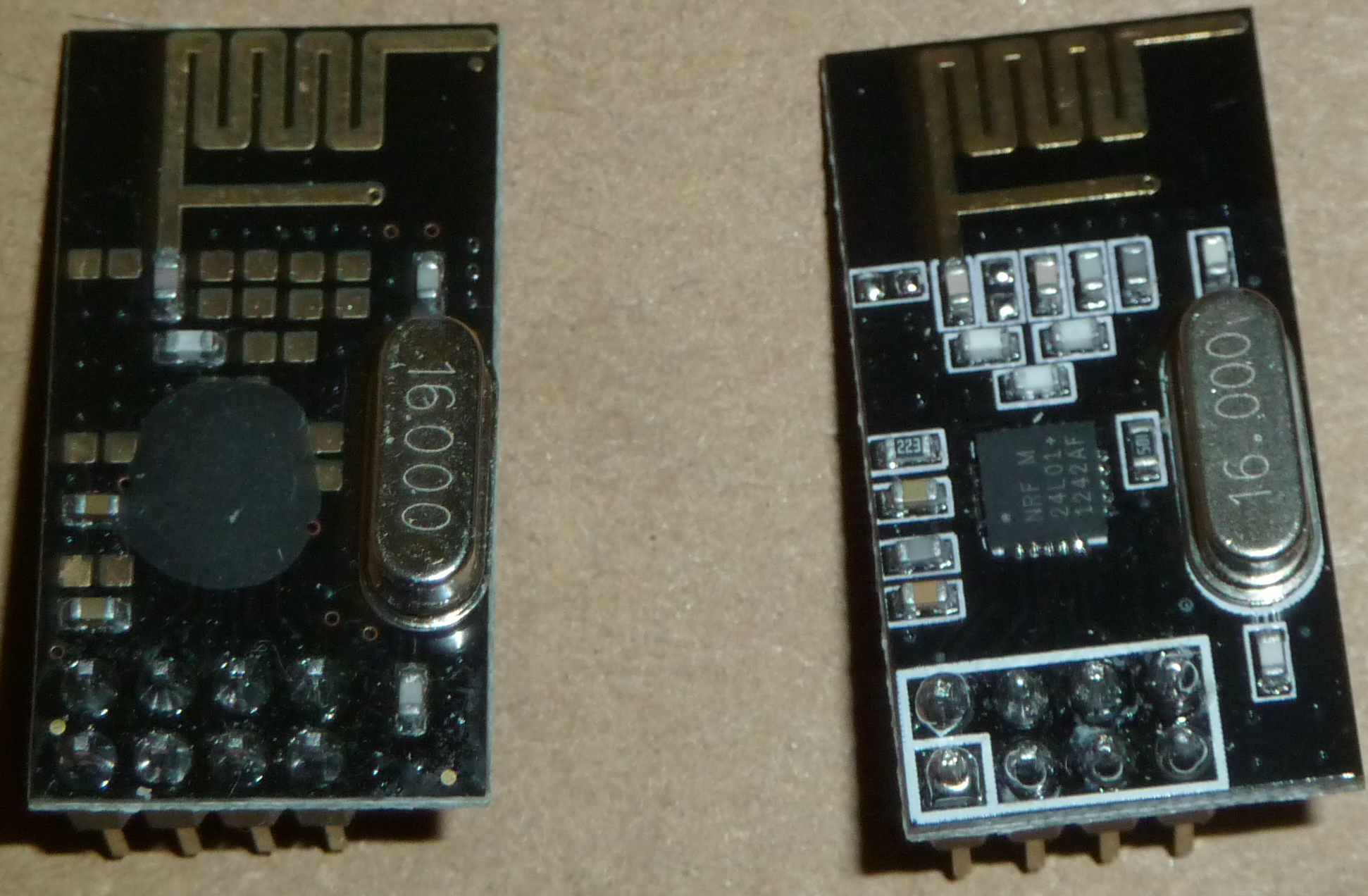

			NeverDie said:That was my first reaction as well. Then what next blew me away was finding out there are at least a dozen different known clones of it: http://www.testandmeasurementtips.com/embedded/pocketpico-p200-powermate/
plus who knows how many other clones out there "in the wild" as it were.
The original motivation for that mysensors thread was me being disappointed in some NRF24L01+ modules that I had purchased................... In the end it may turn out that the transmission current will help differentiate fakes from the genuine article, but the curious twist is that I may have found a cheap fake that I actually prefer!
