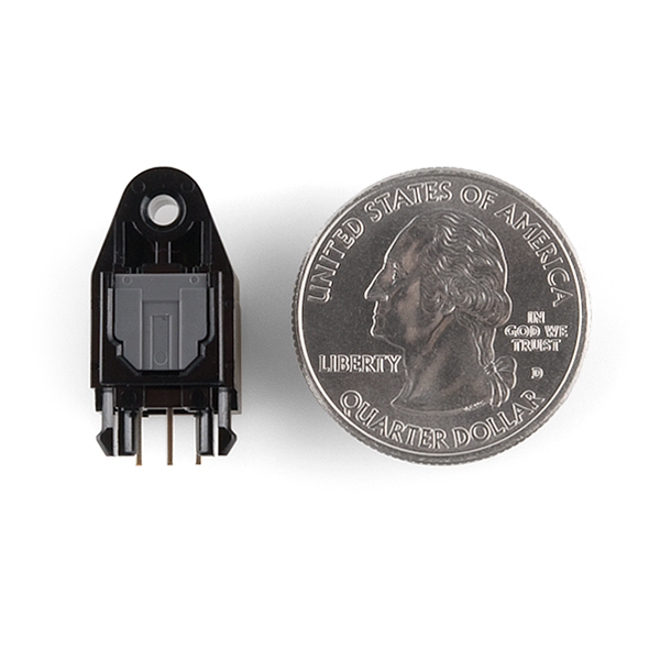

I see that Sparkfun used to sell some fiber optic transmitter and receiver modules that worked at TTL levels and even had example Arduino code:
https://www.sparkfun.com/products/retired/10204
However, they were "retired" and not replaced with anything.  They were made by Toshiba for a digital audio application, so I'm not sure if they were the same or different than TOSLINK.
I thought it would be easy  to cheaply procure gear that does very low data rates, but apparently not.  At higher prices I agree the alternatives make more sense.
