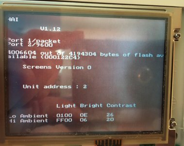

My previous post dealt with network problems I had trying to connect to my OmniPro II, which I was finally able to get it to do with the help of forum members that stuck with me for a few days. But now, since remedying the network connect problem, when the system came up on reboot, the two OmniTouch 5s I have came alive but only flashed text on one console every few seconds (attached). This screen shows for about 3 seconds and quits. The Screen Version says 0, just before the screen quits the version number hits 106 before the screen quits and it goes bank for 10 seconds and repeats this display. the GUI never comes up.
If anyone has any tips or pointers as what I need to do to get these to work again.My hope is the 4.ob ROM chip I have coming with the latest PCA, but I don't feel that is really the problem.

This is a serial connection to the panel via an RJ-45 connection. Check the three wires going to the panel and maybe reflash the device.
