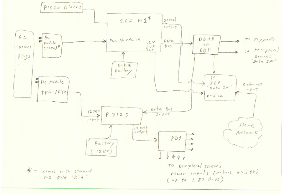

Please check this list I am getting for the Elk/isy994i/insteon system for my home
Pcarfan
Thanks to all the help here, I have my house wired for the following. CAT 6 cables for all keypad, wireless transceiver locations. All the sensor wires etc. I will be moving in about 4-6 wks, I just purcahsed a list of things. Can someone please let me know whether I am missing anything. I am also certain, putting this list out there will help others in the future.

The schematic you gave me a few months ago is tremendously helpful.

Great idea. I will get the 28" can as well.
What components in the list above do you think will go in the 14" can for a clean setup?
There is a list of things I put below what I had already purchased at smarthome. Item #5 there is the extra battery (1280) for the P212S. What kind of enclosure would I need for it? Do you mean the can?, so If I have the 28" and 14", will that be enough?
Item #6 is the adapter plate for the PD9. Will I need another Battery shelf ?(http://www.smarthome.com/1288S/Battery-Shelf-for-Structured-Wiring-Box-Elk-SWS/p.aspx) for the extra battery?
What relays do I need (what is a relay, anyways ? , sry for the newbie question).....I am going off this schematic 'BraveSirRobbin' gave to me. Could you tell me where the realy goes in this schematic?

as whlatimer said, a relay is basically an electronic switch.  You supply power and it switches a set of terminals.  In the case of the Piezo's you need a way to programmatically switch power on and off so the one built in Form C contact for Output 3 will do that.  The "interior siren" wiring positions are for speakers so they can speak the voices - so the piezo's have to be handled on your own via rules.
Other uses for relays - garage doors (as mentioned above), strobes, buzzers (good for garage as warning), sprinklers, halloween decorations, etc.
