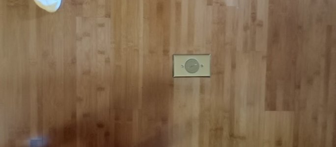

Little project today of removing 2 three way switches. This switches are connected to floor outlets that I do not want switches anymore.

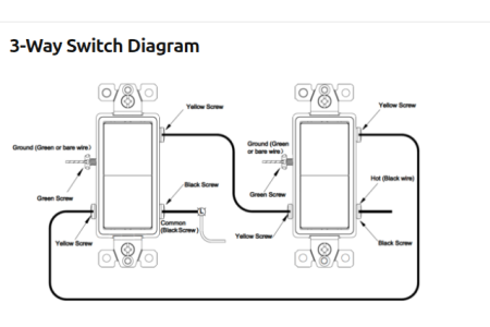

Enerlites 3 way switches bought on Amazon

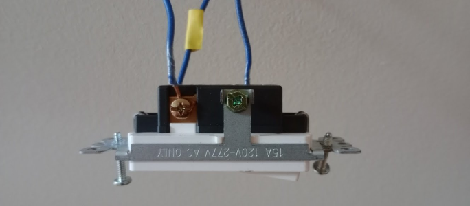

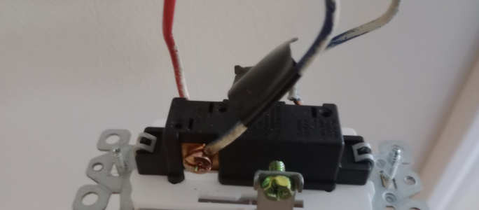

Opposite to the labeled wires is the load and hot wires. So on one side using wago nuts going to bind the load to the labeled traveler and the other side binding the hot to the traveler. Spare wire will be wago capped.
