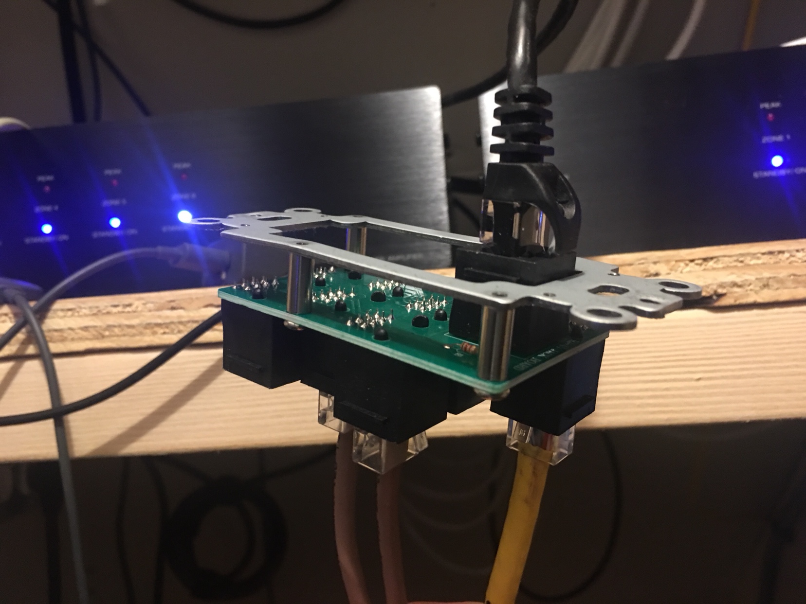

1.  The hub is a small board that can be mounted in a single gang box, although probably a deep one. It has 6 RJ45 jacks on one side for the keypads and has another single RJ45 on the other side that connects to the amp.  No configuration.  I can take a picture.

Thanks for picture, that does help! Curious what happens if you set two keypads to the same address? Can you control a given room from 2 locations or does it just cause a keypad error?
