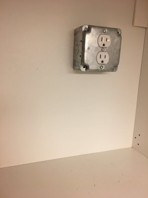

Currently I am mounting my switches underneath my kitchen cabinets. The electrical box chosen to keep them thin has only 7/8" of depth. My UPB switches are all 1.3" deep. Is there any technology that would work nicely with Homeseer that has a thin profile?
