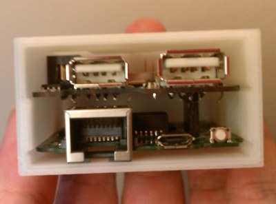

So I wanted an email notification on alarm events before the notification board came out so I wrote some java code to allow me to send emails from a small ARM board and I have been adding features to it since. Currently it is running on a BeagleBone Black in my automation panel and connects to the OPII via the network. All of the configuration settings are in a mysql db and are fairly flexible.
You can send emails based on zone triggers depending on alarm mode.
Emails on Alarm depending on Alarm mode and Time range.
Can send notifications via Twitter Direct Message as well.
Will log zone activity that is selected to log.
Send WakeOnLan packet based on userbutton push.
Supports sending email via gmail. main reason on ARM because of the SSL encryption requirement for sending through gmail and that I love ARM boards.
So the basic reason I am posting is that I was going to write a simple manual on how to use and configure but wanted to see if any one would be interested in using it first.
