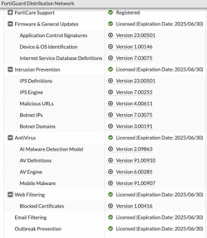

I just subscribed to Apple Music, which I like, but my wife was surprised to learn that when my subscription ends, I loose access to all the music I previously downloaded, yup, that is how it works. At least with Fortinet, you DO keep your existing definitions, but they are not updated.
What you are paying for with a subscription is many files. One has virus definitions, another has mobile virus definitions, another has millions of IP addresses that are suspicious, in many ways, another has definitions of 10,000"s of applications. Some of these files are updated several times per day. So if you don't subscribe, and they slice it and dice it many ways so you subscribe to what you want, than you are not protected to new risks. Also, if you have a suspicious file, then its mailed to the company to be analyzed, and if dangerous, then everyone gets protected.

Here are some of the databases that are updated continuously...
