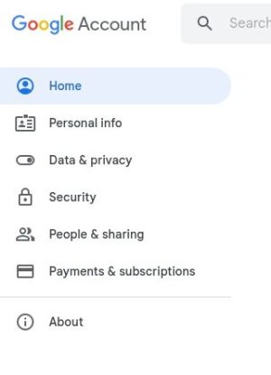

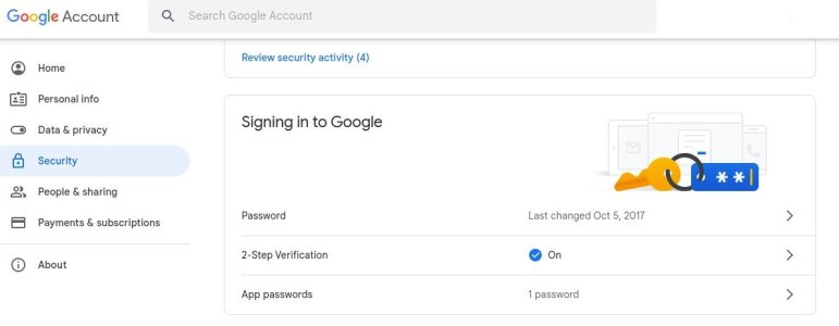

1 - log in to Google
2 - go to Google Account settings
3 - Go to security - App passwords
4 - add a new app and you will be given a new password. Call the app anything you want. I saved the password such that I could use it multiple times.
5 - now reconfigure your smtp gmail login on any app and use this new password. Send a test email and you will see it working fine.
