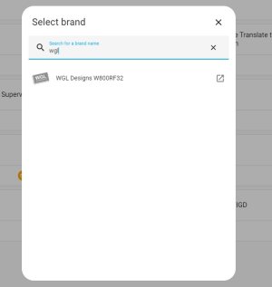

Then after restart go to settings==> devices and services ==> add integration ==> WGL Designs W800
This will only work if you have your w800 configured in the configuration.yaml file.
I search for W800 and click on it.
Select brand​
Search for a brand name
    WGL Designs W800RF32
    Needs manual configuration
I click on it and it brings up the pop up i referenced earlier
This device cannot be added from the UI​
You can add this device by adding it to your 'configuration.yaml'. See the documentation for more information.
I confer that the configuration.yaml has the correct info.
I restart again.
There is no WGL item in the integration page
Its like im going in a loop.

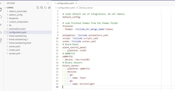

When you did the check on the configuration.yaml file does it show an error. Looks like its just a formatting issue in the configuration.yaml file.
That is why I prefer to utilize Studio Code server to edit the yaml file. It shows indentation errors where as notepad / text editing does not.
See if this works.
Code:
# W800RF32 (Wireless X10 Motion detectors, Mouse traps)
w800rf32:
      device: /dev/ttyUSB0
# Example configuration.yaml entry
# you have to put the following under the binary_sensor: group.
binary_sensor:
  - platform: w800rf32
       devices:
         e3:
         c8:

I'm attaching a pic that shows the configuration.yaml file
I get no errors when I check it the Developer page
After HA has been restarted (multiple times) and I go to Settings - Devices - Add Integrations, I search for WGL but when I click on the icon all it does is refer to manual setup in the configuration file which I have already done.
