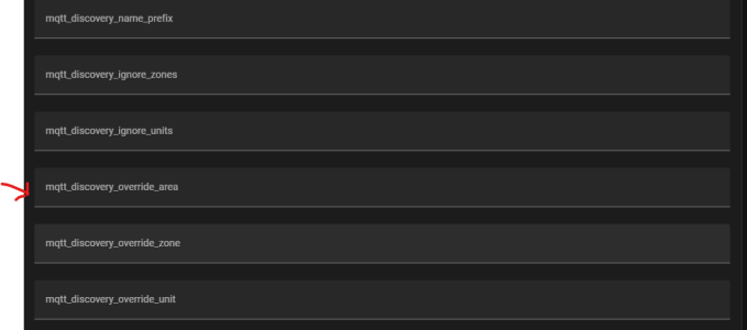

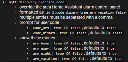

Version 1.1.19 has been released with the fix for Home Assistant 2024.6 and the ability to change the arming modes displayed. Problem is, I cant figure out how to do it. (I want to disable arm_vacation and arm_night)
I think I need to type something here, in the configuration tab:
But I can't get the format correct. Here are the instructions from the documentation tab...any ideas?
Not totally sure but try adding this to the yaml file using the yaml editor
mqtt_discovery_override_area: id=1;code_disarm=true;arm_vacation=false;arm_night=false

I'm not sure which yaml file?
Configuration of the add on. You see it in GUI form and optionally yaml form.
Omnilink Bridge ==> configuration ==> edit in YAML

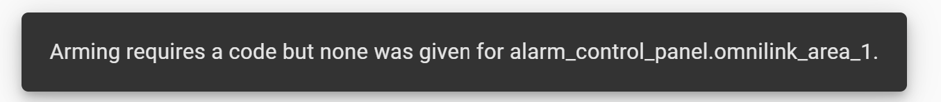

I have been trying to find a useful upgrade to my HAI system and after much research I decided to go with Home Assistant. My current Leviton touchscreens have been spotty and with my newer camera system, are not compatible with HAI. I would like to use Home Assistant to take over as the primary system with hopes of replacing the touchscreens with tablets running Home Assistant.
I managed to get the Omnilink bridge installed on my Home Assistant. I have been playing around with the Dashboard and have the keypad up, but when I enter in the code to arm I get a message "Arming requires a code but none was given for alarm_control_panel.omnilink_area_1." I downloaded the Omnilink bridge through the add-on store which linked me to Github.
Reading the add-on configuration documentation, there is no place mentioned to add a code to validate. It appears it doesn't seem to pull the codes through the bridge. When I elect to not to require a code, the OmniLink bridge will work, arming and disarming the system. I looked through the UI and the Yaml and there doesn't seem to be a place to add this. I'm too new to Yaml to know if I add a section that it will work or break.
Any help is greatly appreciated.

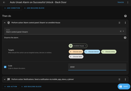

I keep my settings so it will always require a code. When I want to automate a "disarm" I created a code for an automated user in my omni and send that code through an automation rule when triggered.
Example for disarming when a valid code is entered in my back door lock. Check the "Code" box and enter the code you want to use to disarm.

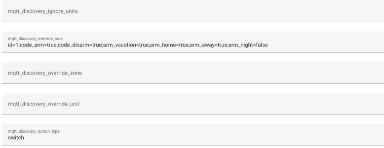

rsw686, I have that command already which gives me the keypad. This is what I have under the configuration area.
This allows my dashboard keypad to look like this.
When I enter a code to arm or disarm, I get this message.
I don't see anywhere in the configuration area where I can enter a code for validation. I switch the view from UI to YAML and I don't even know if I can add a section anywhere that might possible resolve this.

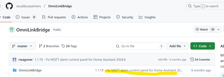

I just wanted to reiterate that when I installed this add-on, I followed the instructions and I directed the add-on to github's code link https://github.com/excaliburpartners/OmniLinkBridge.git
I did notice when I went back to see I was missing something, there was a fix for the keypad (see screenshot below). I'm not too familiar with Github and unsure if it this fix was included when I linked the code or if I have to overwrite something in the configuration file.
