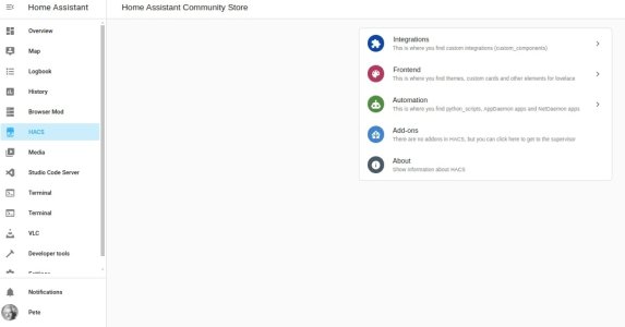

This is what you will see when you click on HACS on the left when it is installed.

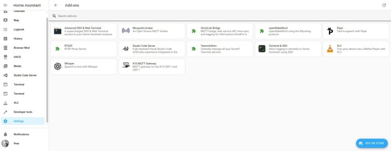

Next you click add-ons ...see next picture. NOTE: this is after the repository is installed.

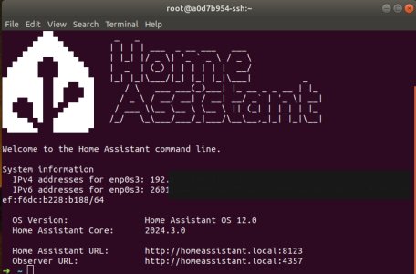

username: root
password: anypasswordyouwant
authorized_keys: []
sftp: true
compatibility_mode: false
allow_agent_forwarding: false
allow_remote_port_forwarding: false
allow_tcp_forwarding: false

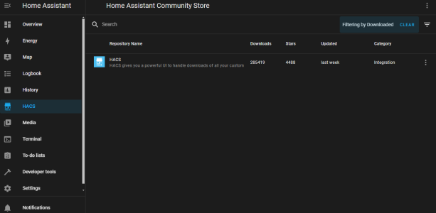

So, this might be of note. I also have the HA app installed on my iPhone and iPad. When click HACS in the right column on the app I get the same result. It just shows the HACS integration but doesn't show the options like you show in your post above. I've now tried to access HACS via hxxp://homeassistant.local:8123/ on my windows computer using Edge, Firefox, and Chrome. Also tried on iPad and iPhone apps.Yes, it's frustrating. It looks like I have HACS installed, I was able to see the screen you have shown above once, but now it only shows me the screen that I shared before.
Restart HA then look again.
Developer tools ==> restart ==> restart home assistant
Clearing your browser cache also works sometimes.

Not sure, why, but it appears to be working! Thank you so much for the help as always.The mobile clients are fine.
