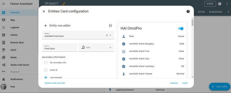

I think it’d be shorter, easier and more future proof to change the name in the customize.yaml. You can also do a global customization and change icons,names, etc.
it accepts wildcards, so maybe you can do it with a few lines of code.
Edit: you can also add a 'friendly name' properties to any entity. This won't break your existing automations and references while providing a more human readable name.
here’s mine, I didn’t change the names but it is possible:
homeassistant:
customize: !include customize.yaml
customize_glob:
"cover.shelly*":
device_class: shutter
"binary_sensor.omnilink_garage*":
device_class: garage_door
"binary_sensor.rdr*":
device_class: motion
"binary_sensor.omnilink_pf_*":
icon: mdi:window-closed-variant
device_class: door
"binary_sensor.omnilink_trmst*":
icon: mdi:thermostat
device_class: heat
"light.omnilink_ris_*":
icon: mdi:radiator
device_class: heat
"switch.omnilink_irrig*":
icon: mdi:sprinkler
Thanks Pete! Looks like I hadn't named any of the entities in the first place and they had defaulted to the names read by mqtt. All fixed!

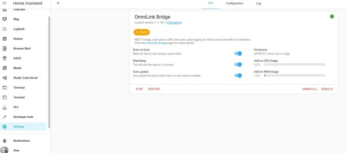

6 - Go to HACS ==> Addons ==> Add on Store ==> Omnilinkbridge ==> configuration

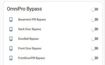

The question I have is that it shows every one of my doors and windows with a switch in case I want to bypass that sensor, which I don’t want to do. in fact I don’t want any of the doors or windows to show it all. Does anyone know how to turn off the dashboard

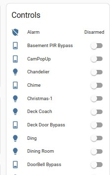

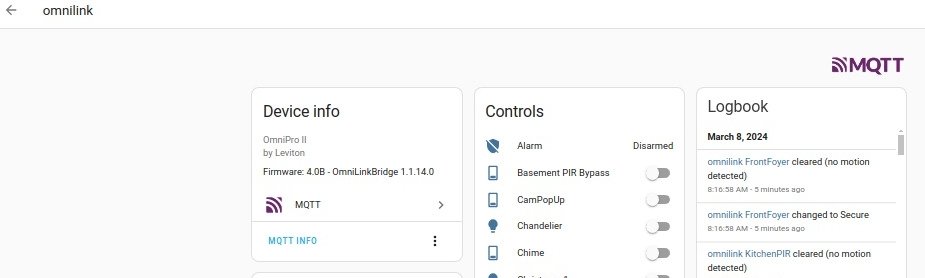

1 - go to settings ==> devices and services ==> devices ==> Omnilink
You will be at this page: All you care about is controls and sensors on this page.
2 - copy all of the controls and sensors to your alarm page. Edit them any way you want. Easy peasey stuff.
Go to the main page OmniLinkBridge for set up and display of variables.
The OmniLinkBridge add on also adds a bypass variable to each sensor / zone under controls. You can chose to display this variable / device in the dashboard.
Here is the top section of the controls variables. Set up a box on your alarm page with just the bypass devices if you want.
Call it Bypass controls or bypass zones. You can build the alarm tab / page / dashboard anyway you want.
Keypad bypass
