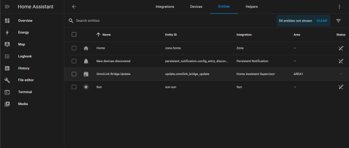

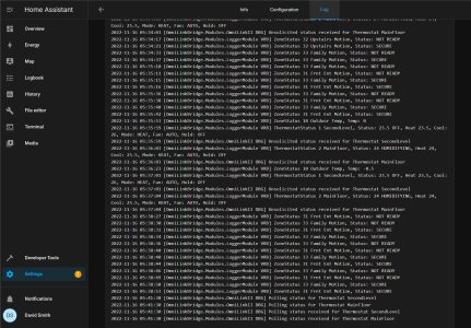

I still have all my cards from my snapshot from before but all Entities are listed as unavailable (see screencap). Further, none of the entities are showing up under Settings > Devices and Services > Entities. I'm not sure why they're not being brought into the database. I can see the communication in the OmniLink Bridge so they are being read by the mqtt (see screencap). entities.jpglogs.jpg
charliebarns
So I went through that process this morning. I also uninstalled and reinstalled OmniLink Bridge and did it's configuration from scratch. Still no entities showing up. It's like it is not bringing them into the database. The hidden entities are just various iphone and Pi entities - no OmniLink entities. Also strange how there is an OmniLink Bridge Update entity:

The HA Mosquitto broker needs to be running. Test by installing MQTT Explorer on another computer on your home network. The OmniLinkBridge is an MQTT client. You should see your OmniPro talking when running MQTT Explorer.
Good news!!!
Well its the broker cuz the plugin is already talking MQTT. Check out MQTT explorer. You can see your MQTT traffic live there.
