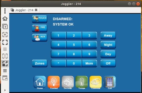

So doing a granular watch. Noticing the slow down and error only occurs when trying to change the screen size with the setup mode. All of the configured and running (15) OmniTouchscreens are configured for a 800 X 480 screen. I was able to replicate one licensed version to 15 touchscreens. They all show the same license which works for me.
I have OmniTouchPro configured with only the pieces needed to run on PlayOnLinux on my Ubuntu Laptop. Looked at all of the configuration files and do not see any DNS or IP's from the Internet. Next using a hex editor to have a look see at the DLLs and or EXE files.
What is good is that I can use the HAI touchscreen designer to change any of these configurations running in embedded XP or the PlayonLinux Omnitouch application. I have Ubuntu 20.04 running on a few of the tabletop screens using an EFI boot bios which will let me run PlayOnLinux and customized Seabios devices which will let me run windows touch tablet.
Got it...needed to re-register the instance.
Did it in dos...
Code:
OmniTouchPro_CE.exe /setup
This part shows an error when trying to update (have not figured out IP address).
It does show the registered serial number. I just have to put in the IP of the controller and keys (again).
It then loads my touchscreen as configured by the designer.
It must resave the configuration without the use of the HAI internet IPs.
I run this application via a Homeseer Touch button and put an exit button on the OmniProTouch screen to return to Homeseer touch.

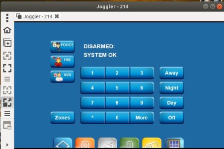

If I run the Omnitouch PE executible it runs fine with my design except that it is larger than my screen 800 X 480.
Code:
OmniTouchPro_10Pe.exe
Will need to revisit each of my touchscreens....not an issue.
