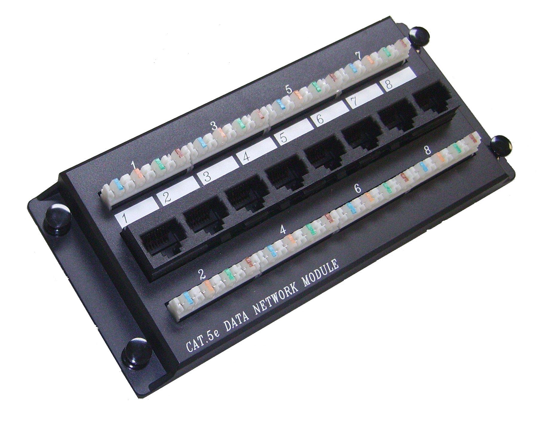

So I'm off to the wiring portion of my remodel. I originally wired my keystones to T568B spec and expected the patch panel to be the same. I ordered and installed some of these patch panels and am stumped knowing that they are wired for t568A. (btw, I found an online PDF with a diagram for the panel from a different manufacturer).
My question is, can I wire this so that it is compatible with my t568B wired keystones? I assumed that I would just swap the green and orange pairs, but that yielded some crazy sequence when testing with the network tester (it would highlight the pins in random order vs going sequentially through the 8 pins as if I was testing a single cable). Am I missing something here?
The default wiring seems to be: blue/white, blue, orange/white, orange, green/white, green, blue/white, blue

@gatchel, that is the default out of the box diagram. I have swapped the orange for green so it is:
Pair 1 is Blue
Pair 2 is Green
Pair 3 is Orange
Pair 4 Is Brown
Just for kicks, wire one as spec'd and go to the keystone - most I've seen have the diagram for A and B - just rewire the other end to B and test (it'd be a PITA to do this to all of them, but it'd be nice to see one test correctly).
@work2play, my keystones are all wired for B. I guess for kicks, I should wire one as an A and then wire the patch panel correctly as an A and see what I get. Yeah I hear the tester sucks. Any other option to testing? Laptop to laptop?

Just wanted to update the info on these patch panels. Now that I think about it, it's stupid simple: just swap the greens with the oranges. This diagram from another company was helpful (not to mention that their customer support was great). I need a couple more of these, and will probably order from them seeing as it looks like a generic identical OEM product with a different name on it.
